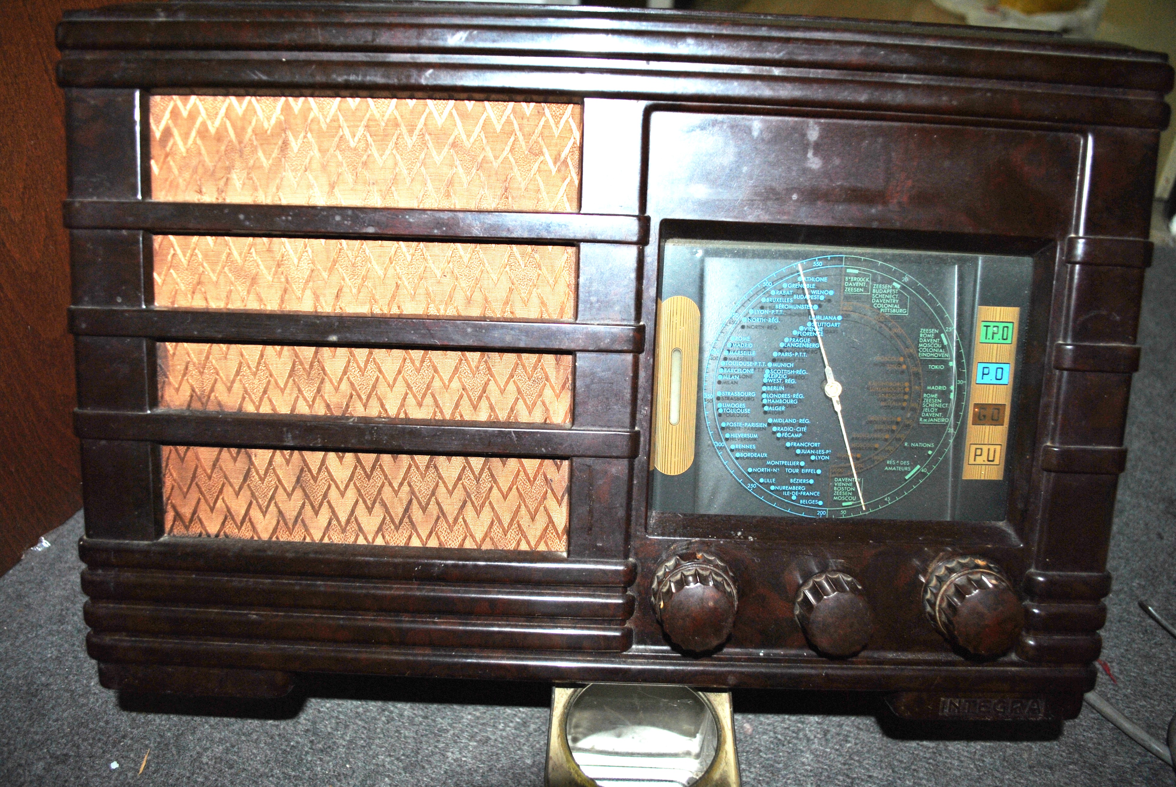

    I find schema France radio Intégra A50. Sorry I don't know French language.
    I'm From Slovakia, from town Bratislava. Greetings all France.
Sujet : Schémathèque Nouveau De bobosse  Le 25-04-2016 à 00:02 sta
    Hello,
    I suppose that you mean ''i am looking for'' instead of ''i find''. If your radio set is that one: http://www.doctsf.com/gra… the schematic is the one i have attached to this post.

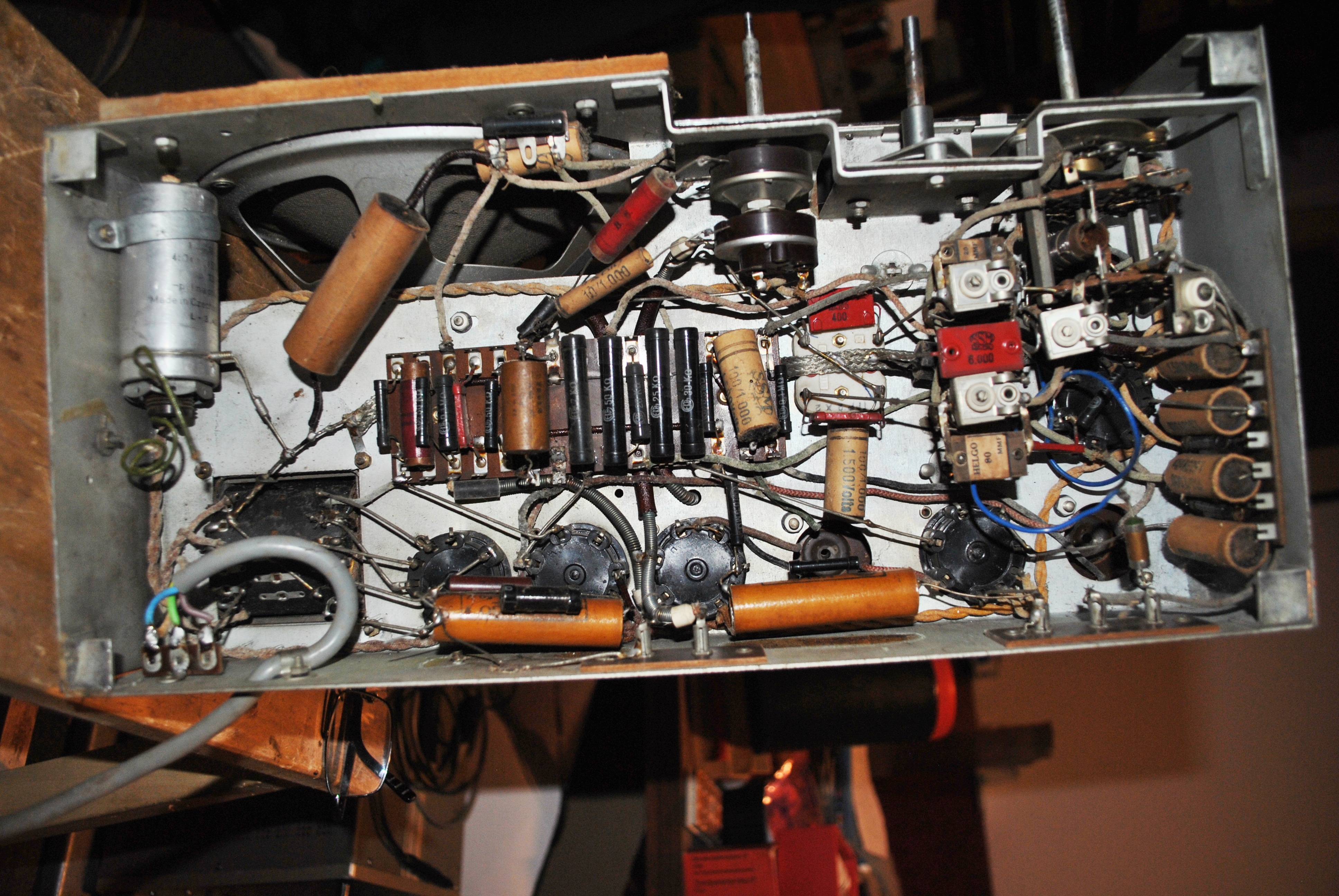

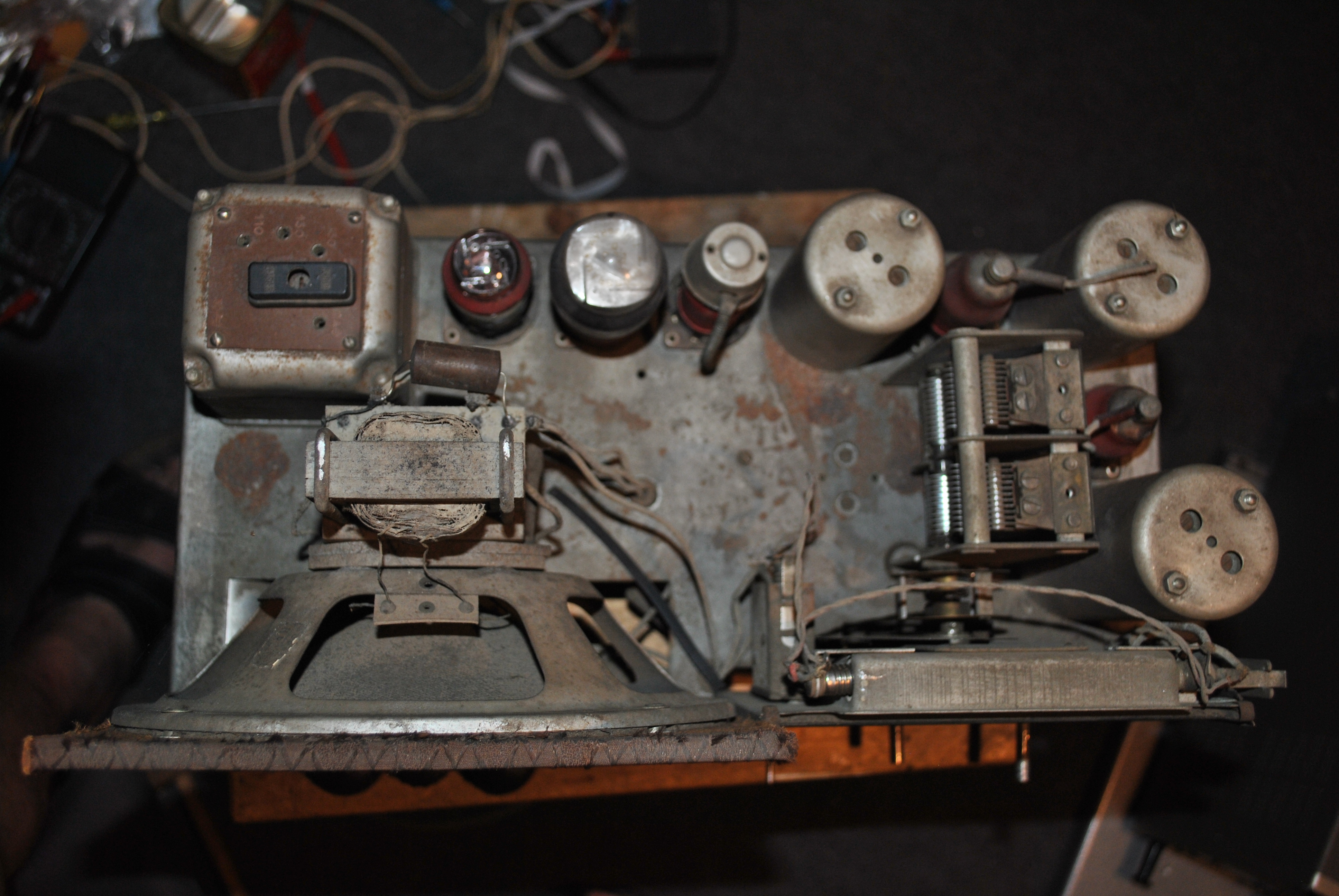

    bobosse, all film ccapacitorss are 100/1000, 100 nF, only one is 10/1000 10 nF. Tube is OK. I connect four photo.
    Thanks for more informations. Milan
Sujet : Schémathèque Nouveau De bobosse  Le 25-04-2016 à 14:32 sta
    Hello,
    If you need or want change them, you can replace them by new 10nF and 100nF 450V ones. Today the quality is much better and 450V is enough.
Sujet : Schémathèque Nouveau De Milan Bratislava  Le 25-04-2016 à 20:53 sta
    Yes I give into 100nF 1000V or 630V. Another scheme is not there? Information about this radio not exist at Slovakia. Thanks. Milan
