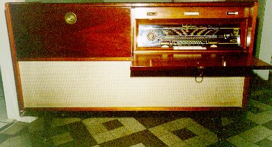

| Sujet : Philips Reverbeo Nouveau | De Luis Engrácia Le 19-03-2004 à 11:41 sta |
I have this radio but i don't know is Philips B7X14A Reverbeo, i don't know the year and the model ( only thing i know about the model is reverbeo). Someone can help me?
Best Regards
Luis Engrácia
